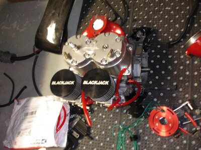

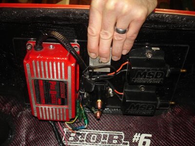

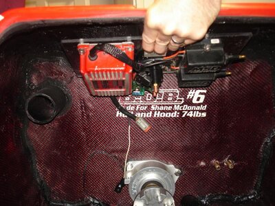

Worked on the total loss today. Air gap, marking TDC, wiring, mounting to a plexiglass plate, etc. The engine bay has so much room it's rediculous. I decided to mount it with a through bolt between the brap strap ratchet and a backing plate. I'm a little worried it may crack under the stress but I don't really think it will.
Started on the fuel lines too when the backing nut for the pickup came loose on my pickup plate. JB weld to the rescue.

Wow, so the brain hangs almost upside down? I wouldn't worry about the poly carbonate breaking... I'd be worried about water running down the backside of the total loss brain all the time.
Get some neoprene washers to put between the plate and where the bolt passes through. Also put a washer where the bolt head contacts the plexiglass.

It has a plate that will distribute the force of the bolt. It's pretty big. You can see it in the pic if you look close. Look at my fingers holding it.

Reading through the instructions for the total loss says not to mount the coils and brain within six inches of each other. Uh Oh. Does this really matter? I'm guessing it's about 4 inches right now.
Who really knows. Buddy of mine bought one of Tera Laho's RIVA Promod Superjets years ago, the Total Loss was set up by one of the best guys in the business and he did it just like you have yours.
SUPERJET-113
GASKETS FOR CHAMP BRAP!
Thats exactly how my MSD dual digital TL is mounted. Your good to go Mcman, no worries.
