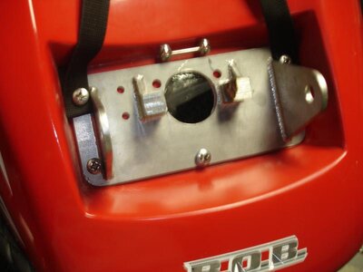

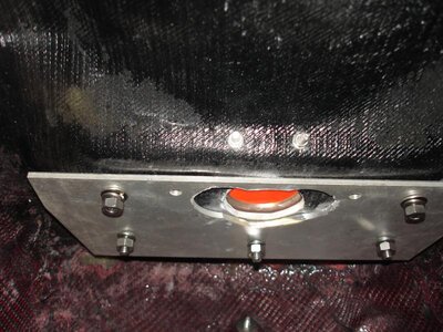

It has a plate that will distribute the force of the bolt. It's pretty big. You can see it in the pic if you look close. Look at my fingers holding it.
When I ran that enclosed box at Daytona, it was being held in place with only 3 bolts with washers. I did use some rubber washers to help absorb the shock but considering the flex that whole box saw, I'm sure you'll be fine. Actually, since your system is mounted almost upside down, your system will see less stress than mine did because the system is being held almost completely in tension. I bet you don't even need the plate but it won't hurt. Maybe even squeeze some turf in between the polycarbonate and the hull and between the polycarbonate and the metal plate you made.

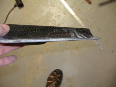

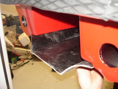

Cut up a composite ride plate to fit. Made it a little extended. Then I noticed that the carbon fiber seems to be delaminating. Is this something I can save by pouring some eopxy on it? May have to go back to the drawing board if that doesn't work. I have some stock rideplates I can cut up if I need to.
I also did a LOT of grinding to get the 24/7 bracket and backing plate in.

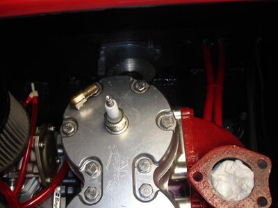

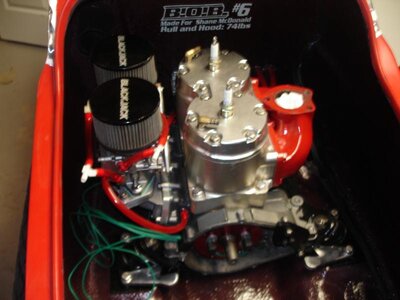

Motor is lined up and installed with tons of room to spare.

l think you could pour some epoxy in it and then C clamp it.Should be strong.Worst thing to happen would it would delam again.
