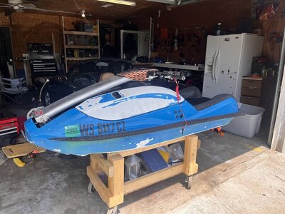

So I threw the rest of the ski together quickly, and ran to the lake. Got it in the water and she ran great!
Still not sure on that pole. Stiff pole plus short length plus flat bars is all new to me. I've never liked flat bars, but I'm gonna keep trying the pole position.

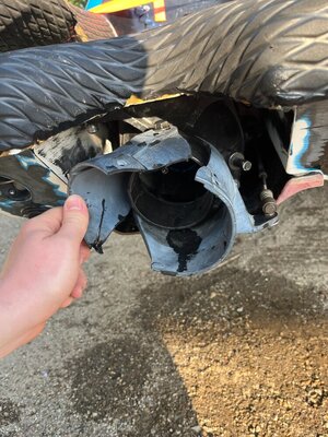

Day ended when I somehow cracked my steering nozzle? No idea how that
happened.
Successful shakedown all in all! My god this thing is fun, rails on a dime, lightweight, feels great, and bloody tiring to ride.

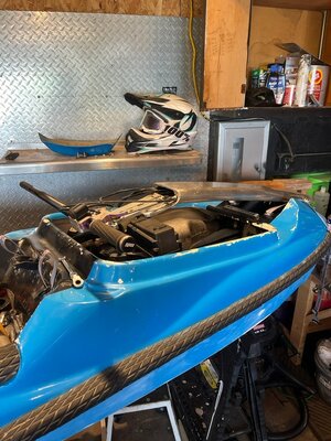

Pulled a thread outta the hull. Aluminium blocks glassed over are nice and easy, but the threads have a lifespan. I retapped them all to 1/2-13 and used the EZ LOK stainless inserts.
Seriously. These things are awesome. We use them all the time at work (steel processing) and I've used them in engine blocks holding head studs on and they work great. I likle the coarse UNF external that has a lot deeper bite than metric bolts in aluminium. Great holding power.
I retapped all the threaded holes to fit. I figured it was only a matter of time until I pulled the rest. Reinstalled engine mounts with a little dab of anti sieze and I'm much happier cranking on them now.
