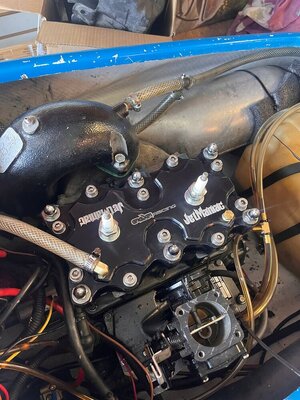

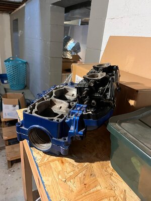

Night before I slapped an ada head on it. Runs excellently. Probably the last mod I'll do before winter teardown. I think I'm gonna attempt a home ported 701 this winter. I have a spare motor and I'll need a project to keep me occupied, so I figured why not. Worst case scenario I learn something. Not a bad return for a few hundred dollars.
I'm probably going to use the yamanube templates and attempt a bit of 62t case porting based on what I've been reading up on and talking to others.

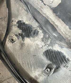

Finally I was taking paint off the bilge earlier to make new tank mounts and... Is this a carbon hull?!

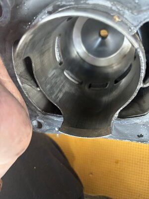

So I blew my top end up, I think I forgot a cooling line. As soon as I could feel it running weak I killed it, but I think it was too late. I could smell it. She was gone. Expensive licoriceing mistake but one I hopefully won't make again.

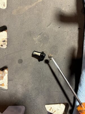

And then it all came undone. Ski would run for 15 seconds and die. Paul thought I may be getting water into the combustion chamber - it only happened coincidentally as soon as I saw water from the pisser. In retrospect, this may have just coincided with how much fuel was in the carb. Checked my o-rings, looked good. Checked the exhaust gasket, didn't look great. Faced my FP manifold at work on the Bridgeport. Paul sent me a new one as well as a new base gasket since I checked that was seated properly too. My waterbox was rattling, surely that was it! Cut it open, baffle is loose. Okay, so I welded it back up sans baffle. Back to the lake, same issue. Take my jetting back to as before, same issue. Something is really weird. Changed my ignition coil, stator, CDI, SAME ISSUE!
Sitting at home ranting, my wife comes with me to the lake and sees me run and immediately says "Sounds like you aren't getting any fuel." "No no it can't be, I didn't even open the fuel pump side up! It's the same as I've been running all year!" Labor day morning, I decided I'm gonna get to the bottom of this. Pulled my carb off and...
Fuel pump side was disgusting. Internal filter totally full of poop. In line fuel filter looked good. I've been running this carb since May with no issues. I canot believe it ever ran like this! Huge thanks to Paul. Worked with me through every issue, even though ultimately it was nothing to do with him.

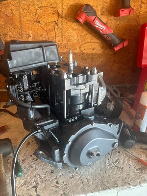

I don't have too much to add. I put my 735 Shredder top end on a set of 62T cases. Twin 38s, I did add a zeel which I'm looking forward to trying. Hopefully going to pick up a 10/16 hooker when I get the chance.

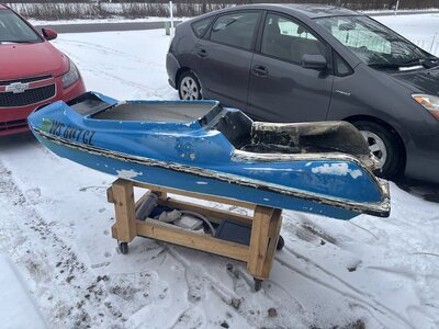

Ski is stripped. Turf is out. Ordering fibreglass soon and reinforcing the pole area. patching some holes, etc. Considering rockering the nose just to get rid of that ugly flat nose. Probably won't though.
Gotta get rid of all the foam, do my glass work, sand her down ready for primer. Probably just gonna blow a single stage white down.

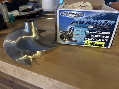

I spoke to Paul, he suggested I pair a 10/16 with my setup. I'm running a set of OEM 38s for now because that's what I had. I'm hoping to use what I have for now and likely step up to a bigger overall driveline package in a few years.

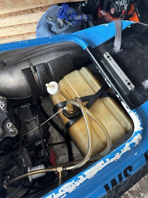

Parts are stacking up. 144 10/16 and a new Brandon SFA tank.

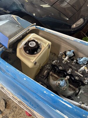

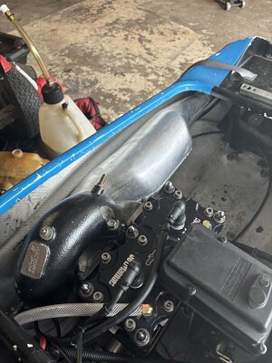

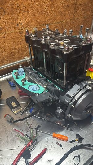

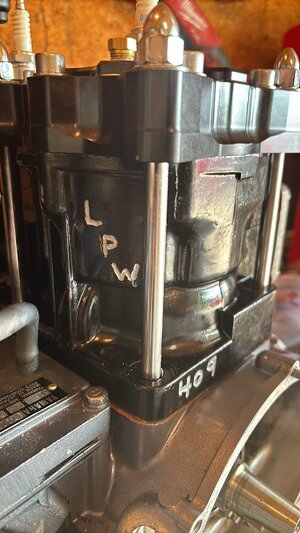

I might need to move my engine back, the pic is where it sits now. I can get a better photo tonight. I'm thinking about picking up a short GP800 midshaft and reglassing the engine mount bolt plates back when I do the glass work.
Any guidance or tips? The engine sits pretty far forward in the hull as you can see. The tank just about fits. I would be a lot more comfortable with a bit more space up front.
Last year I did stainless inserts in all of the aluminium plates glassed into the hull, so I could feasibly reuse those.
I remember when the Hookers first came out, It was around 1776.............. LOL, More like 1476! That said, everyone was screaming get a 9/15...... They were running the old DASA cast cylinders, stroked motors........ I called Dave told him my spec. 84mm Big Bore 61X. His response "10/16". He was spot on. I later in life tried a 9/15, It bored holes in the water. Later had one pitched to 9.5/15.5, I had dropped back to an 82mm ported 61X. The 10/16 worked just fine with it, just tried to tweak it a bit with the custom pitch. If you have bone stock cylinders and pipe, 9/15. Any other mods, 10/16
