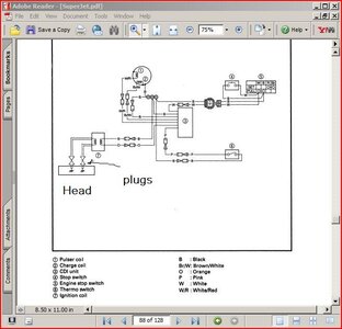

i may not be the smartest man jenny, but i do knowwhat a TL diagram is. How is the energy to the coils different when talking about the stock system vs what the flame sends to the oem coils? i am asking because i want to know.

do you know for a fact that msd made less volts on the multi channel? or is it now just using more energy than is required to simply fire the plug. i think they use more power than required.
If the TL is using the OEM plug @ set to OEM gap and only firing one plug.

It's not something to worry about unless you're buying a timing light. You want to get the t-light with a direction inductive pickup so it only flashs once per revolution. The volts to the plugs are A/C. lol it reverse polarity for each cylinder.
