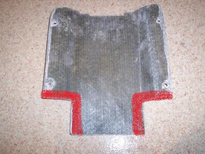

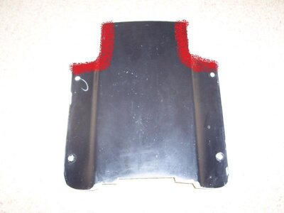

If you want to bring the nose down that extra little bit you can do a few things. First, you can add shims under the rideplate at the back bolts to give it a bit of a downward angle and that will bring the nose down some.
If that isn't enough you can scarf out the ride plate like I'm showing in the picture and put a few layers of fiberglass on the top and the bottom. Just sand it down at an angle on the top and bottom and progressively add bigger and bigger layers to both sides until it's flush.
