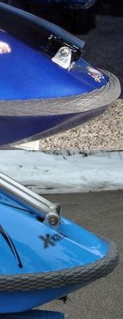

Funny... That's exactly the opposite effect that I had. I'm thinking your pole is too far back. I can't tell for sure because you don't have a pic of where your bars are located in relation to the tray but here is a quick photo edit between my hull and yours comparing the mount location.

i wow, yea thats gotta be my problem then. not sure how im going to fill in the bigol cut out and hole where its mounted now though.....

Yeah geez dude... You couldn't keep your nose down for anything. I don't think relocating the pole now is going to be the best idea. Maybe shorten the pole? Shortened turn plate?
My pole is standard length but the turn plate and straight bars take off about 3 inches from the stock bar location. What is the straight distance between your pole bolt and your bars (center to center)?

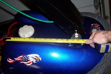

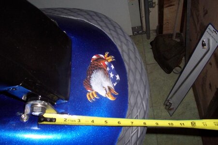

Here are some quick measurements from my ski. Center of pole bolt to the front edge of the ski is 8"-8.5" depending on where you take the measurement (center of ski to side). Center of the pole bolt to the back of the nose is about 13.5"-14" (estimate since the back is curved). Center of the handlebars to the center of the pole bolt is 40.5" measured in a straight line.

from the center of the pole bolt its 11.5 inches to where it starts to turn down on the top, and about 9 to where the turf starts on on the nose. so about 3 inches further back then yours. how did you know where to mount yours at?
