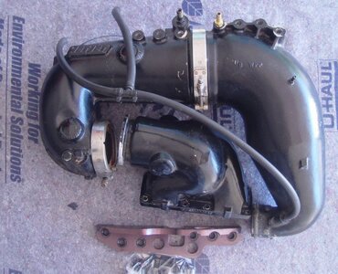

I think it is a Motoine Kawasaki pipe, but I can't seem to find any info on it. I found this one as well.
Yep had them bring it to worlds for me. Anyone who wants one. Hiro can translate to get anything here.
Half dry with water injection. It's a very cool setup.the way it loops up im guessings its a dry pipe....with possible water injection?????

How does the half dry work? The wetjet pipe (made by westcoast) is supposedly a half dry, the manifold and first part of the "headpipe"is dry, and the second part of the chamber is wet. Would this be a similar setup? Plus the wetjet mani is equal length, it's a really nice piece that I think would work well for a custom pipe.
I never knew that's what was in there. A friend has a wet jet and I looked right at that pipe this summer. Pretty cool setup.
