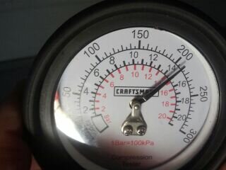

Finally had to know what compression range Chucky was aiming for on this build, 210 both cylinders tonight. That's a bit higher than expected but factor in a lithium battery and high torque starter and sounds just right for 93 octane.

i ran back to back comp tests with deka etx16 agm and anti grav 20 cell and got 11 to 12 lbs more in readings ...not much danger in setup wake failed attempts,just go for it.Ive been trying longer distance no trim back flips off a nice wake boat a friend has to try and make it to the other down side of wake. Those can be some higher speed carnage crashes when ya come in a bit short of nose down...lol

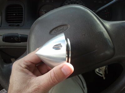

Well this motor setup is fully tuned now, added a stubby tail cone and running b-pipe
with only top screw open one turn. I really have no excuse now to not try a setup wake flip now...but yesterday the water was real choppy (what ? another excuse ? ).
Btw these stubby cones work well compared to the huge ones that come with the solas mag and combined with a bored 85 mm nozzle.

the mini cones do help a good bit with the hooker prop in a solas mag,I think the 7 mill cutback is too much in a solas mag,so the short cone relieves some of that extra low end load to get it spoolin. ive tried 2 hookers in the same pump with same hull,very sim motor cc. I want to try the thin blade skat with not as much cut back 11/15 or so next
