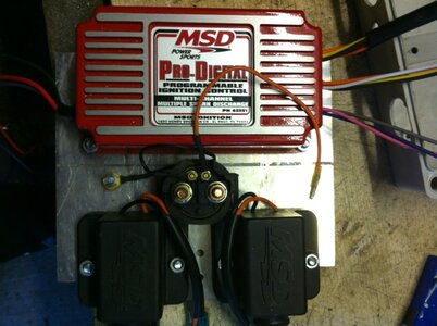

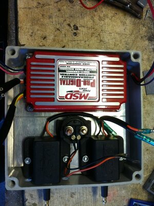

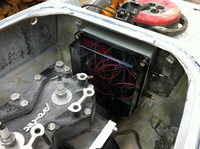

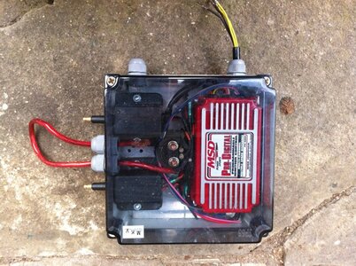

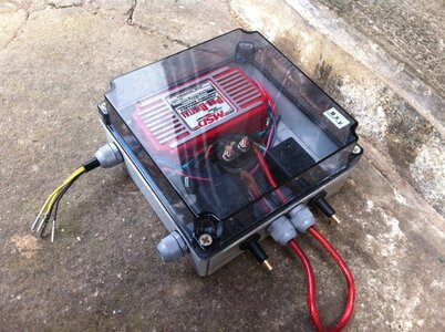

Hi

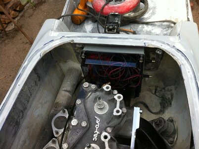

When i connect negativ wire from Battery to the Plate, the coils have enough negativ connection ?
I can ground everything to this plate then, right? How thick need this cable to be? Not as thick as the starter cable, right?
And the positive can i can take all from relais?
So, only wires going out of the box are -> Stator cable, 2 coils for ignition, 1 negativ cable, 4 Start/Stop cable
is this right so far?
It fits with everything
