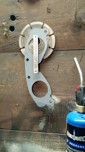

Its always a possibility but I trust that they sent me decent stainless. My laser setting could be the issue like you suggested. It's the only setting on our new laser that produced a black mark that looked decent. The other settings burned the hell out of the tag and left a really rough mark. I absolutely hate our new laser but it's the only one I have access to.
I can try tweaking it but I have no way to test what setting will rust faster. All I know is this one looked the best.....

Ok my test are leading some informative results. Now I know my setting is the problem. It rusted almost instantly. When I developed it I used and acid test to make sure it wouldn't fade. That setting performed best on that test. I honestly didn't think that any setting would be prone to rusting on 316. I'm sorry for not testing for that.
Two settings (out of 128) are showing promise. They are dark markings and have yet to show any signs of rust so far. If those two settings fail the rest of testing I will be discontinuing my product. If they pass I'll be back in business.
That leads me to my request. I need someone to test these in saltwater. I am low on inventory so I can only send out one more test tag.

I have lots of experience with laser marked 316 failing salt spray testing.
Have you tried passivation after marking?
Punch the numbers into the 316 instead? It won't look as good, but maybe it will survive.
What about a thin aluminum strip that is clear anodized? You can mark through the ano onto the substrate below.
Thanks for the suggestions. I don't have access to a punch to punch them. Also, I thought about aluminum but it corrodes too easily in salt.
The new settings have proven successful thus far, even in salt. If they continue to prove successful I will start marking them again at the end of April.
