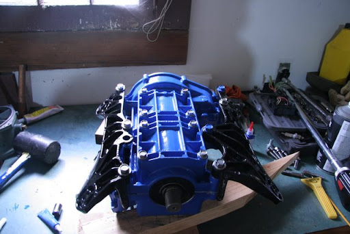

So I decided I would run up to hydrotec and have them double check the measurements that the orielys guy gave me... turns out he measured totally wrong. the bearings are the same size. the metal ring is bigger on the the new bearing though so they pulled the ring off the old bearing and put it on the new one.
and now I have an assembled bottom end. the top end should go together friday night.

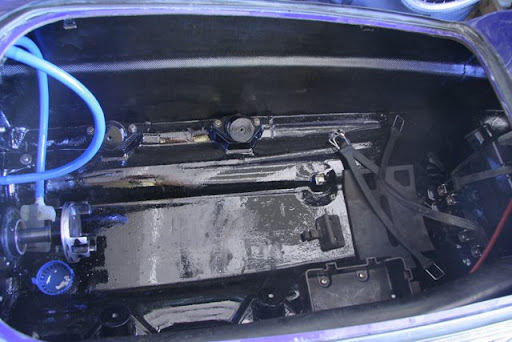

well I have the water box in and most of the other little in hull stuff done. The motor is about ready to drop in I think. the carbs are rejetted and ready to go. It should go pretty quick from this point on I think.
