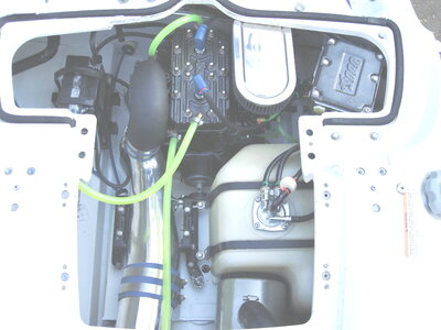

Here are some pics of mine. No GPS but It's does somewhere near 52mph and gets there fast.
Here are the specs:
1992 Kawasaki SC
PJS Viper 9000 800cc 100HP
PJS 650 Exhaust Manifold
Coffmans Full Exhaust
Jetinetics LW Charging Flywheel
Skat Track 12 Vein SS Magnum Pump
10/18 Skat Track Swirl Impeller
PJS Rip Turn Reduction/Trun Nozzle
DG Intake Grate
Custom Ride Plate
Reverse Eliminated

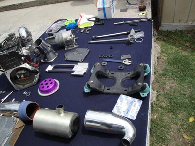

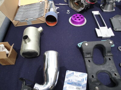

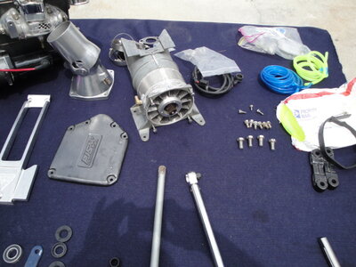

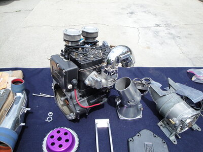

I got most of the parts I need to start the build up. Minnetonka4me hooked me up and was real reasonable to deal with for parts. Thanks man.
I need Kawasaki advice.
1. What is the water drain valve do...other than the obvious? Does it act like a flow control valve for the water box? Can I block it off/remove it?
2. Can I leave the oil pump installed and just block it off? I'm going straight premix.

If you're talking about the drain valve in the engine, then yes it is just the obvious. The less than obvious is that it a great source for an air leak and burn up your motor. Yes you can and should block it off. Not sure on the other question.

I can get the block off plates to you, honestly I usually leave the crankcase drain, yes you hear a lot of horror stories about crankcase drains with no evidence whatsoever to back them up, I personally have yet to see one fail. I have however seen many of them do exactly what they were designed to do and have a water flooded engine back up and running in a matter of minutes.

I was lucky and got a water valve block off plate with o rings from ocjumper when I bought it. I'll leave the oil pump till I have a minute to fab a plate. I was just outside and was checking engine/drivetrain alignment and found out that the midshaft/driveshaft holder bearing assembly is shot. The bearings are seized. WFO, u have one of those?
