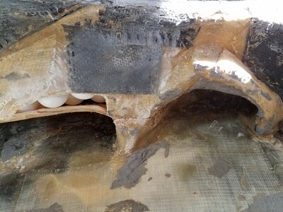

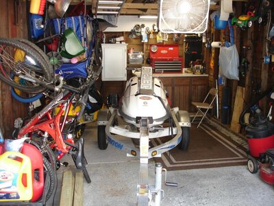

Light and strong!! Until it gets water in it over time. I drained a lot more than I expected when we got back to the ramps. But when we first went out I was like oh yea! Boat wake rolls are easier/faster for sure!
Between all the pool noodle and pool noodle surf board (big custom cut piece hugging the waterbox with straps going through it like a stock mat) I have in the engine compartment and the 1000 or so beer pong balls inside..... it felt like it will have zero problem floating as good as a stock ski.
Now I have a pair of 16mm aluminum versiplugs coming to scupper the water out of the tray and I am done. DSC05652.jpg
DSC05689.jpgDSC05687.jpgDSC05653.jpgSo now worst case senario I lose all power/bilge and it ALL fills with water in the surf and floats as good as stock or better IMO.

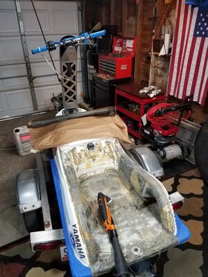

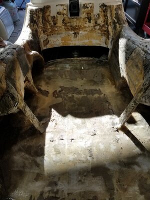

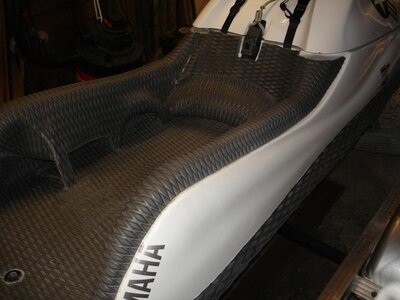

Well Petes in the shop getting some new steer wheels and some other goodies...and I can't sit still.....so I am ripping this tray out to see where so much water gets in when I sit.
I think I might flex seal the entire inside and then go with the blue foam this time...NEW WHEELS.jpg
Ohio
Oh nevermind the tray held up great and is solid except for 1 little spot...a crack! A little material and new turf and good to go....pong balls are still packed tight and look good...so they are staying.

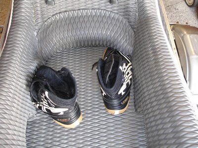

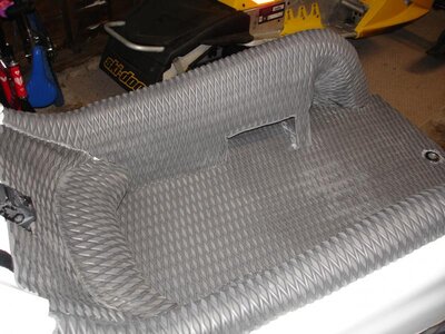

Tray 3.0
This will be the last mod....just integrating the front hold in to the hull.....and then sanding smooth and reinforcing/giving her one nice full carbon tray look.
Then fresh 25mm padding and blue turf.

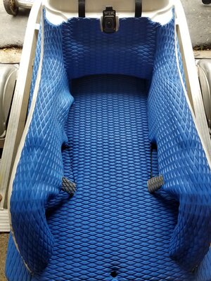

OK all weak spots ( I ran out of materials last time!) reinforced and then everything sanded and shaped to perfection. The tray still looks like arse but I don't care. The turf came out good I think!
The front foothold feels great!
The ping pong balls all looked brand new and were packed tight! I was only able to squeeze 3 more in after all she has been through!
