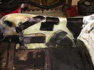

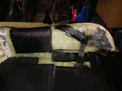

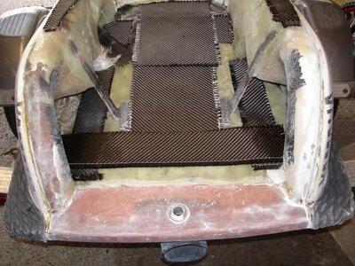

Almost out of material.....a litte more reinforcing on the guns and all 3 holds and tail tonight....
I stood in it and checked it out all out last night and loved it!DSC05615.jpgDSC05613.jpgDSC05612.jpgDSC05610.jpgDSC05606.jpg

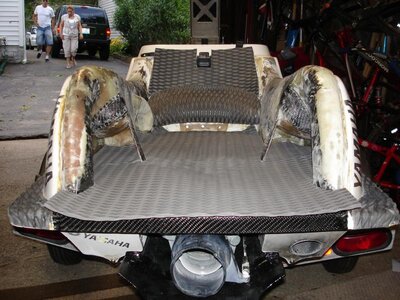

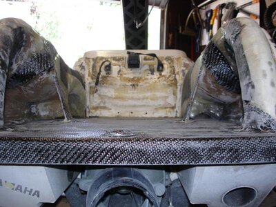

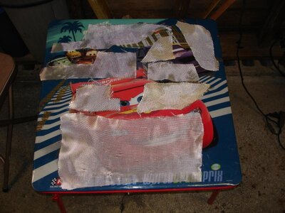

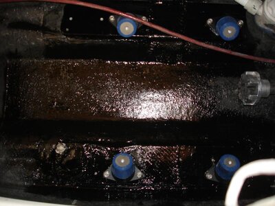

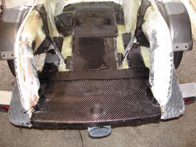

Hand sanded the entire tray with 40 to smooth it out...cut all remaing glass in to strips and used it all up....and then put another layer of resin over everything...
I cut around the tie down and sanded it back a hair and then put a 5200 barrier between the tray and the tie down....

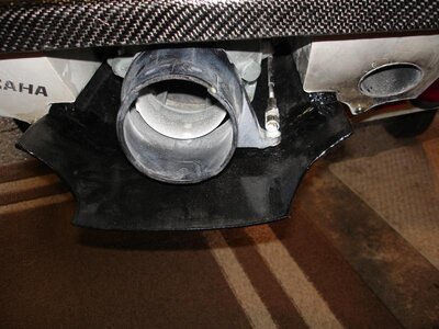

The engine compartment needed some love....

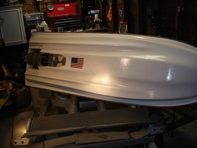

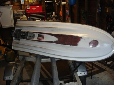

And then I couldn't just leave the bottom all beat up after going through all of this crap....so I plucked a cheap cloth flag out of the front flower pot (I was a little worried but low and behold! THESE COLORS DON"T RUN!)...sanded her a little....gave her a layer of resin...and a layer of paint....another layer of paint soon.....

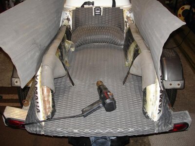

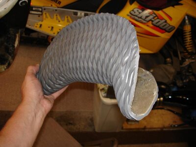

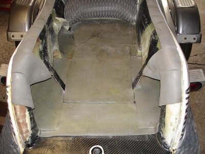

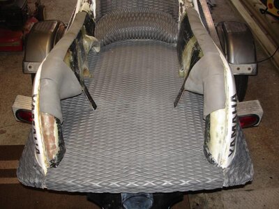

Finally got around to turfing my front foot hold the right way.....

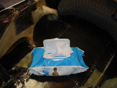

I found a small spot above the new hold that was kinda weak but I was out of glass.....so a dried out baby wipe saved the day...
I am using my modded WDK plate for sure...

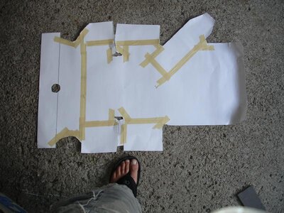

The first time I ever used a pattern for a tray....worked great!
No more 25mm padding for me....it crushes and makes the turf wear out quicker IMO....and I can't "feel" the ski as much with 25mm....
8mm padding plus turf plus 4mm socks in my wrestling shoes should be more than enough....DSC05640.jpgDSC05627.jpgDSC05637.jpgDSC05629.jpgDSC05631.jpgDSC05628.jpg

did i read that right? you used a dried up baby wipe as fiberglass? lol i think your my hero!
LOL..yes...see that thick piece on the top of the front hold....

Almost done!! I still think you will cut out those foothold kickstands after the first ride...
That front foothold kicks ASS
Ohio
I don't think so but you never know....I have ridden with enclosures before and liked them for certain things where both of your feet are back in the holds.
Yea I'm diggin the front hold too!
