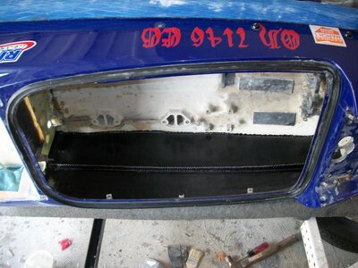

here is the reinforcement of the engine compartment. i also did glass reinforcement on the inside sides of the gunnies. for my layup i am using 5.7 oz 2x2 twill glass and 5.7 oz 2x2 twill carbon fiber.
