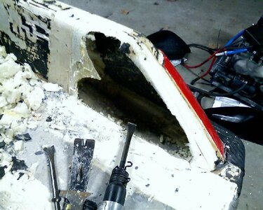

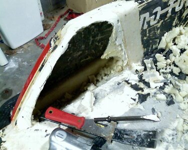

So far, I've got the left foothold out (in 4 pieces) and discovered some wet foam, all around the bondline so far. The right side is the bad one based on how badly it leans in the water.
And, my air chisel is AWESOME for this. That combined with my 12" pry bar has done pretty well so far.

Here are some camera-phone shots.
I decided not to take real pics of this process and just focus on getting it done so I can ride again.
