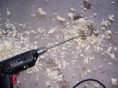

And I discovered a new tool, a drywall mud mixer on my drill. Wow, it's like popcorn flying out of there, no dust, and it's a power tool. Perfect.

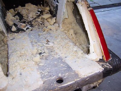

I have the access plate cut out, and probably 1/2-2/3 of the foam out. There is water everywhere, so I'm glad I'm doing this, though I knew from the leaning that it had water.

Looks like you could do some major destruction with that new power tool thingy, probe, digger, whatchamacallit.:boggled: :biggrin:

Wow, that works pretty good. I imagine without having to film, and using two hands on the drill it's a lot easy to keep control. Very cool idea. :biggthumpup:
