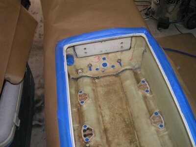

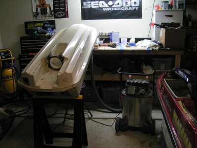

Well I ordered more glass today. Last night I set up one hull upside down to asses how big of a PITA reinforcing the pole mount will be. Looks like a huge PITA, but I am going to do it. Hardest part is going to be the prep.... I will chronicle it all and post it in this thread, pictures and all. Stay tuned!

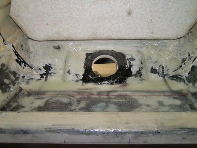

Well, I just finished laying a layer of glass on my handlepole mounting area. What a giant pain in my arse, wow.....I am not as happy with the results, but thats what the 90 grinder is for tomorrow - to clean up my bad spots. From prep to glass, it just plain sucked. I ended up getting 2 layers just under where the bracket would go. All after filling the big voids in that section with thickened epoxy and then grinding the ribs down. I also filled my screw holes with a dab of silicone before I laid glass. You can hopefully see the results in the pics - maybe not. I left the 2 big ribs running front to back on the outsides of the bracket bolt holes and the glass just wouldn't lay down in that area, so I just cut the glass to help it lay down.....looks like hell... oh well, hopefully it is stronger.

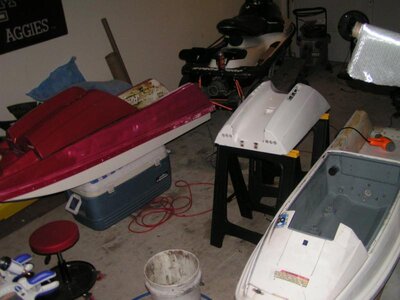

UPDATE:

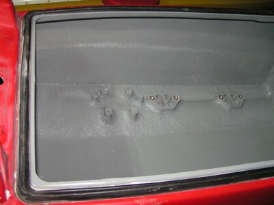

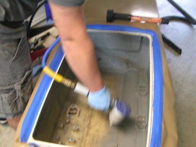

Well I hadn't planned on making this into a build thread but I'm too lazy to start another one. Anyways, ski's are both reinforced, this past weekend Travis and I painted the insides of the hulls and are now prepping for outside paint. Got a good bit of parts on the way from a few different members, thanks guys.

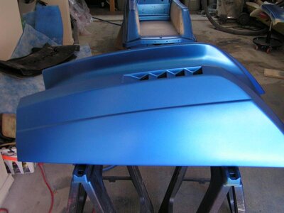

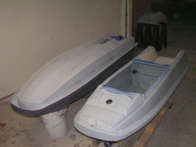

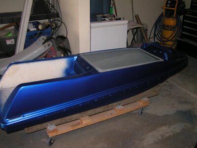

Lots of work going on this week. Looks like the skis might be ready in time. Below is the progress. Cheers:beerchug:

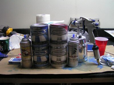

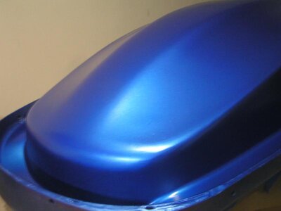

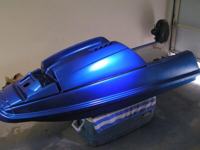

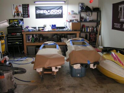

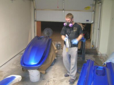

Penguin, sorry for not calling you, we just sort of met up friday night and got to work. To give you a bit of insight, we were peeling vinyl friday night. Started prep work early saturday morning. Sprayed and cleared the bottoms saturday night, sprayed and cleared the tops sunday morning. Pic's below show the results.
As for what paint we used, we were debating using Imron or another high durability (and price) marine paint. In the end, what you (Penguin) said about "why don't you guys just rattle can 'em" last week really hit home. Our philosophy basically came down to "well, they're gonna get f*cked up, why spend alot of money?". So we decided to try out the Duplicolor (from any autoparts store) "Paintshop" line. Sure, it may be sh*tty paint, but it's $22 a quart and easy as hell to spray and work with. Paint was sprayed with a $40 Kobalt siphon-feed gun (which Travis had laying around) and the results were astonishing.
Sure, the hulls aren't perfectly straight, and they have a few dings and chips that were too deep to fill with just primer, but we weren't going for a show class paint job. As for the spray job,, they look great. I still can't get over how pretty this color is. Should have them cut and buffed by this weekend.
Total Materials for Both Skis:
8 Cans High build primer ~$50.00
2 Quarts Blue ~50.00
2 Quarts Clear ~50.00
Total Cost per ski: $75.00 (Can't beat that)
