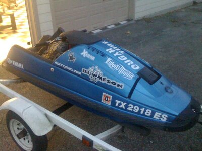

The paint is holding up decently, although as I had expected it is pretty scratched up after a couple years of hard use. If I had to do it all over again I would have used about 3x as much clear as I originally did. I'm still happy though given that my $75 paint job still looks pretty good.
As for the RN pole on the modified bracket, yep - it's still going strong! I would like to get a Hazzard bracket at some point.
Now I am building a 62t/61x motor and am debating on whether or not to chop the hull up and do some radical glass work.
Pic from this past summer:

Evolution of a superjet.
I posted these pics in the showing off thread but figured I would just keep this thread updated-ish. Ski has since had the hood mod done as well as a newly built 701 and a b-pipe. Also deleted the fuel door.
