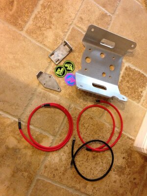

I am not sure where I am going to locate the eBox, so I ordered the longer battery cables. I also ordered the front ebox bracket since it seemed to be a nice clean setup. However, since talk about getting the weight toward the rear has me second guessing if I'll use it.
It's all about balance
Ebox is maybe 5 pounds to the right to offset the chamber.
The motor being back is 35-40 pounds more than a 2 Cyl.
You'll end up using the kit up front. These conversions are not nose heavy and the bracket actually DOES aid with balance.

Chris, thanks for the additional input.
Regarding the balance of the ski, is that a big deal especially while riding? I have a superjet and it leans a bit sitting on the water. I thought it was funny when I saw a post from a newbie SJ owner talking about "my superjet leans to one side". For a SJ, it's normal and it doesn't matter when you ride. I wasn't sure if this 1100 B1 was the same issue, or if the ebox location up front was highly recommended for handling.

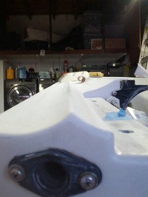

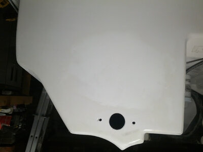

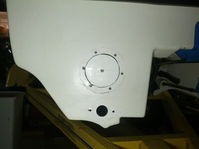

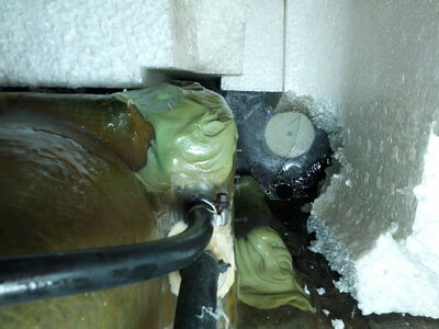

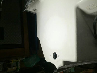

Earlier I had to remove the smaller diameter Riva rear exhaust which was located on the wrong side for an 1100 conversion.
Luckily, I took a hole saw and bore out a chunk of the ZXI hull to use as a plug. I mixed up a batch or resin and hardener, brushed it on a mat and placed it on the inside of the exhaust hole. Then I put the plug on the outside. I used masking tape on the outside to hold the plug into place.
now the backside (inside):

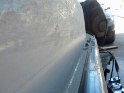

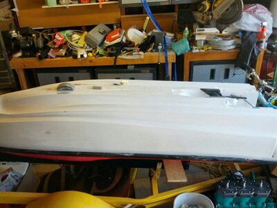

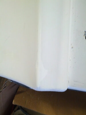

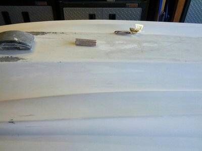

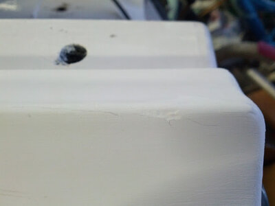

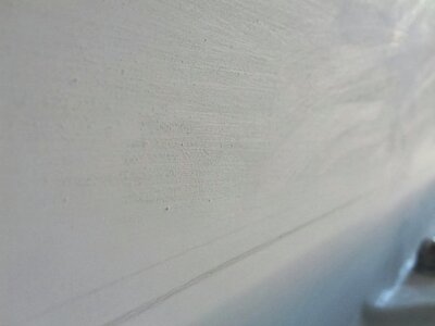

Flipped over the ski to start bottom hull work. Took a heat gun and removed all the decals. Now I needed to fill the holes from the rear sponsons. There were a few nicks that needed to be filled also. Therefore, my brother and I sanded, then started putting on marine tex.
Truing the hull

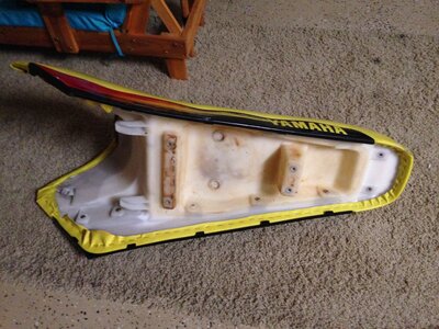

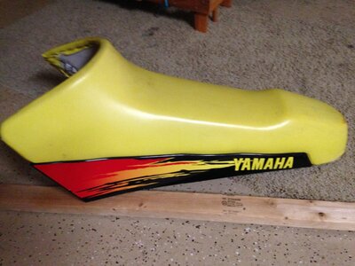

I stripped all the parts off the bottom portion of the seat. Trying to make it light as possible before I ship it to JetTrim for a new cover.
Hmm, should shave that hump or leave it cool retro?
