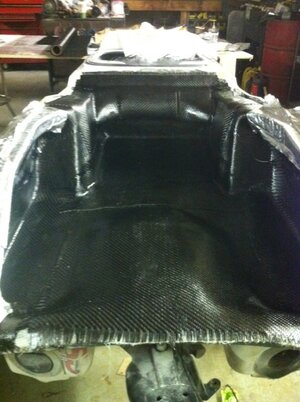

Ok I just dont get why Rickter would make the tray so narrow. With your feet in the foot holds you are at a stock SJ tray width. And foot holds on any other ski get your feet wider.
When looking at the brackets there is a ton of dead space behind them.
So a few cuts and nut serts from the inside you gain over 3 inches of total width.
Straight line cut
Heat and pull just the turf up
Draw center lines
Drill
Nut sert and tighten down
Re glue turf
Now don't get me wrong it was hard to cut into these $$$ holds but this is just somthing I had to do. Who wouldn't want a wider stance.
