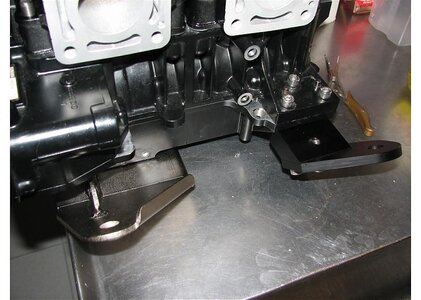

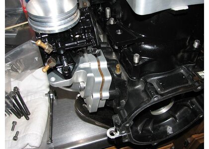

The Waterdawg vertical mount kit came in the mail today! If you are looking to put a 66e in a SJ or whatever it is well worth the 399 for the kit. You can bolt this thing on and go in just a matter of minutes. Direct replacement for OEM mounts in the rear. The bedplate uses long studs, but then again just bolt it on and go. The bed plate is beefy also. No bending that thing
Although I did not need the kit to get the ski on the water I decided to pick one up b/c I am running MSD TL. That way I can service the pickups w/o having to pull the motor. I trimmed the stock mounts off the flywheel cover w/ a band saw and that is about it. Bolt the kit on and go!! Plus I just think the motor looks better sitting vertically

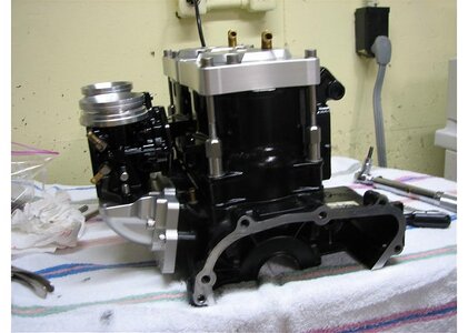

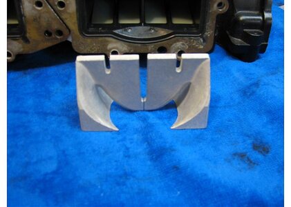

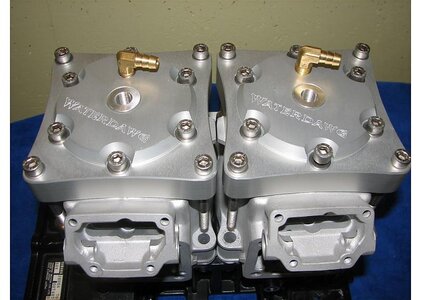

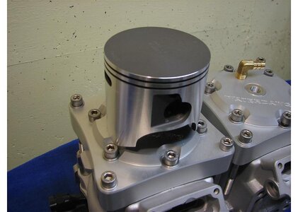

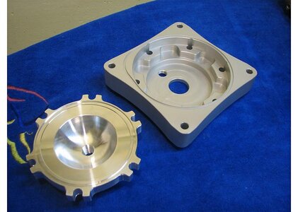

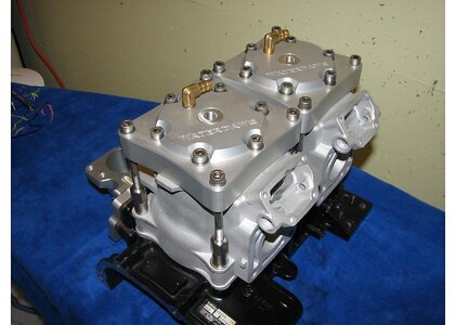

More motor pics.............

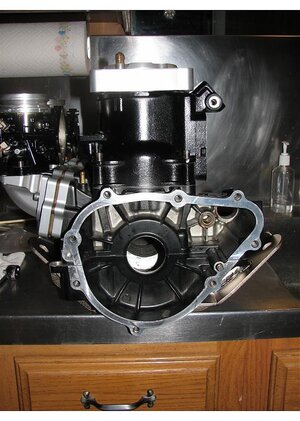

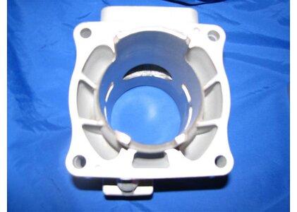

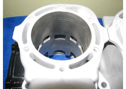

Painted cylinders and carbs................
