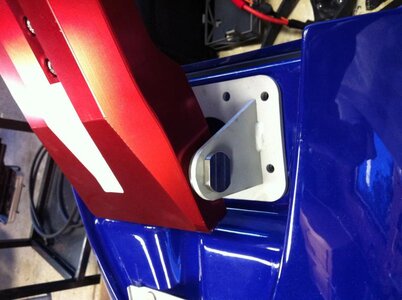

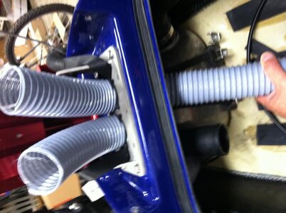

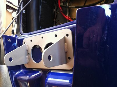

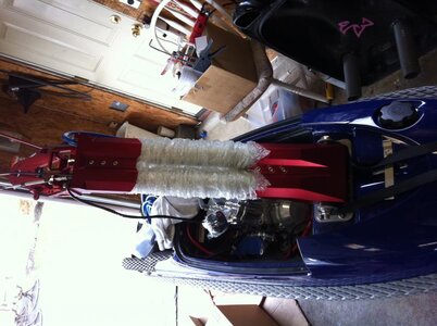

Decided to make my own a little over 1" forward pole mount to help make the nose come around quicker on back flips and give more control the everything else. It still 1" lower also like most other good pole mounts out there. Went with the Billet RRP pole here but decided against the double bolt idea. They came loose to easy. Stuck with a single stock bolt for this build again.

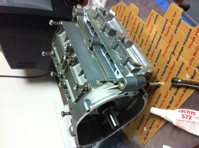

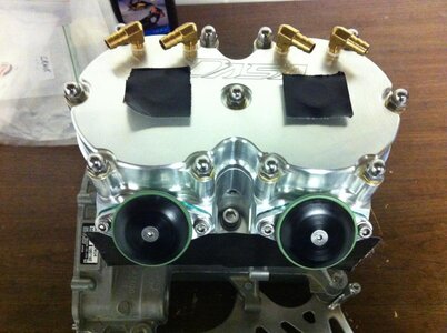

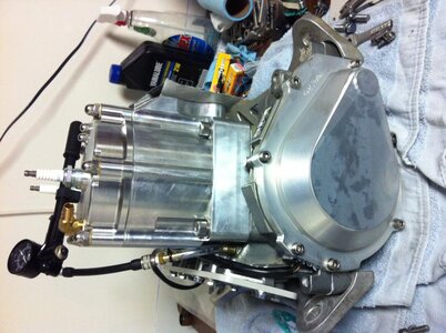

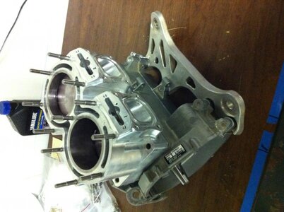

Got the DASA 850 PV all cleaned and put together and pressure tested.
Cases were trenched, epoxied, and ported by DASA on a CNC. Very nice work.
Its a little more difficult to build than a stocker if you naver have before, but considering I had built over 400 4 strokes in my life I figured I'd give it a shot.

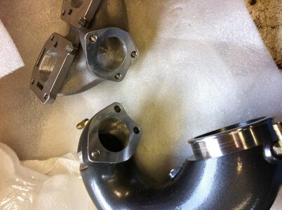

Cleaned up the new factory pipe and smothed out the rough spots from the machining. Decided to go with a MOD pipe again, ill never go back to a limited again. tried that twice and neither time did it work out for me. But i did manage to waste a lot of my time and money trying to see if it made more power, it didn't IMO.

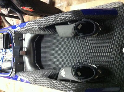

Finished up the turfing, installed the footholds, adjusted them, and installed the front foothold with Styrofoam behind it for extra floatation and strength

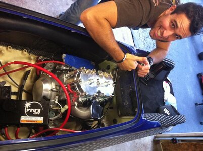

Drew stopped by to help me set the new motor in. I think his reaction is worth a 1000 words here

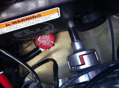

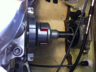

Now comes the fun part, I had to swap out the motor mounts, couplers etc as I broke all of them on my primary boat that day, so this baby gets all new cold Fusion goodies to go with her CF stator cover

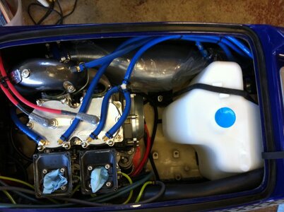

Installed the Rule 500 bolge and wiring to the dash switch, I use that plastic with corrugated cover on everything now since i wore through some wires one time. I use that stuff any place there is a sharp edge. always on the pole and steering areas also.
As you can see I went with an entire new electric box etc with an ETP Epic with the A and B switch so I can compare my timing to the MSD enhance curve that I programmed into curve A. should be interesting to see the difference between the two.

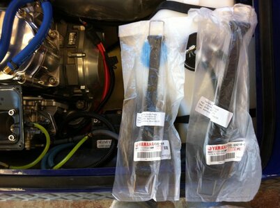

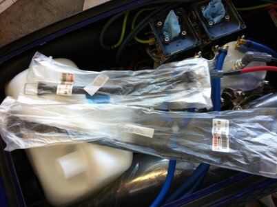

Even bought new gas tank and battery straps. I did not want any left overs on this build.

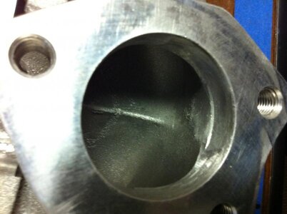

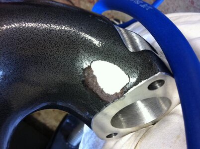

Thought the Factory pipe would clear so I never test fit it to the motor. Little did I know I would spend HOURS grinding this spot and taking the manifold on and off numerous times to clearance it.
It looked like it was only hitting by about 2 or 3 thou every time. 11 times later I just grabbed the big grinder and hogged away at the exhaust.

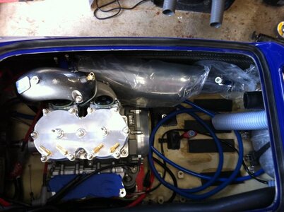

Installed the Full Spec 46mm carbs jetted to 130 Pilot and 130 Mains 2.5 N/S with 22 psi pop off. We all think it will be rich on the pilots but I was too lazy to listen to Pat. Pat suggested 120 pilots. We will se when we fire her up.

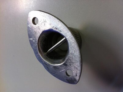

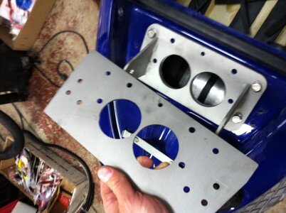

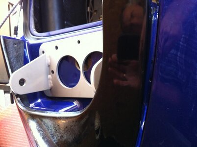

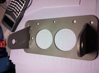

Decided to go tith old school stock flame arrestors. Tehy would not clear the motor so i lasered up some 1/4" aluminum for a spacer plate to rise them up. Probably would use 3/8" plate next time, but i was worried about hittin gthe hood when I made them. Now with the XFT hood there would have been plenty of clearance.

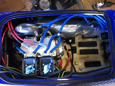

Shes all installed and shimmed in perfectly resting quietly in her new home. Can't wait to beat on it the first time out!!

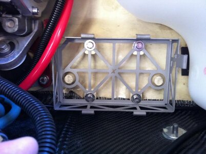

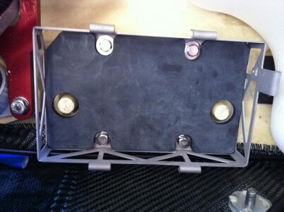

Installed my left over battery box I made years ago. This was the super light weight version. I still prefer the ones where i didnt X cut the sides just the bottom, but this was all I had left and its the same one a lot of us have been running for years.

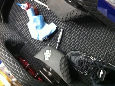

I installed RRP steering and chin pad, 50 mm riser bars, 2" bar extensions, ODI extreme grips, riva throttle and the thrust trim handle that I had to bend to get the last ten degrees out of the trim.
Now I really need to cut the back of the boat to let the trim clear the hull.

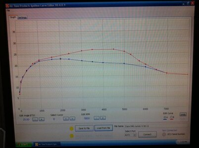

Im still having issues on figuring out how to upload stuff to this site after all these years but here is a picture of my current curves.
There is a huge difference between a MSD Enhancer curve and my homemade curve shown here. Id say a good 5-10% difference in the midrange to top end. Carbs clean up better after a stab or roll, ski feels cleaner everywhere in the powerband. All the guys in Team Extreme will want to try both curves for themselves to feel the difference.
