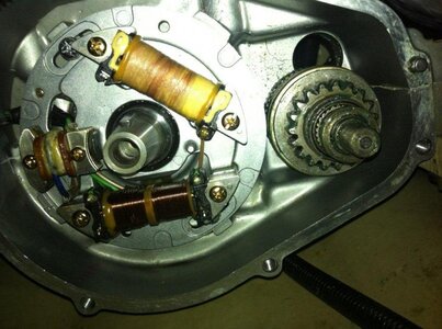

I removed TBM and installed 62T, wiped key way and reinstalled. never really inspected it but i did take this picture.
New OEM 62T stator is on the way
You bring up an interesting point. IS IT A 62T stator I bought it with a motor and never ran it. Can you tell by looking at this picture?

I can't tell by looking at the picture. Does it fit the flywheel very closely? (I.e., no big gap between coils and the flywheel magnets)
Do you have another stator to try?
