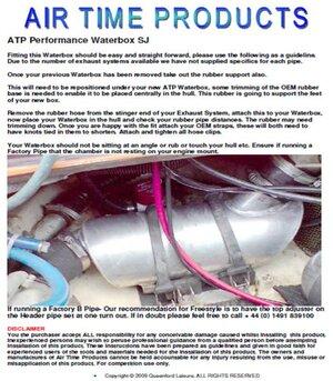

Here is my modded atp wb. Fits perfect of course ya can do same with rubber elbow like sanoman and get same results!

That's a great mod and fits well.l didn't like the idea l had to place a pipe to join the elbow and exhaust but 0 issues so far.l went back and forth as to which box for my ski.l'm happy with the xscream and it sounds great.

Really should have some turf or the oem rubber under the waterbox, otherwise you risk rubbing the edges of the waterbox on the hull and wearing/burning a hole through
TN
So ur saying the rubber bumpers on the box are no good? The box isn't touching the carbon anywhere to the best of my knowledge. Ill throw some turf or pc of rubber in when I put in my new motor mounts tomorrow.

better safe than sorry.... i threw some turf under mine, straps hold the box and turf dow just fine and theres no risk of the box ever touching the hull... you know how thin these roks are!
TN
Yeah but mine is thicker than most I bet. Its pretty heavily reinforced mainly so I would not have to do it after I broke or cracked it which still could happen on had fails lol
