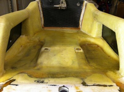

Some updates.
Hull, hood and nosepiece are painted. Waterbox is in. Pole bracket on. Maniac strap back on. New hose in polebracket (home depot freebie lol) Pole got some paint on it. Front towloop in.
Waiting on parts... But the ball is rolling nicely. Getting some love from Orangefinger, Jetmaniac, and Hardcore. If things go right it will be getting wet in a couple weeks!! Wooo!
I'll get some updated pics up in the next couple days.
I just wanna friggin ride!!! Ghaahhhh!
NVJAY775
My home away from home.
Well the motor is shimmed and in. (Thanks Orangefinger for helping me out with the motor work and parts) Pipe in. I friggin choked HUGE on my waterbox. Tried to cut a corner and have it welded back together for rear ex and didn't check out all the angles. So it's effed and is getting pulled and benched til I get ambitious again. I might go xmetal box, not sure. Or just stock rn box. I dunno.
Here's some updated pics. Still in semi mock up, but with a few stickers for up side down motivation.
Not too much left... Waiting on a few parts to finish trim, turf (need to order a friggin waterbox) and a few other small things. Should get it wet in just over a week if things go right.
