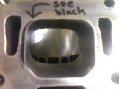

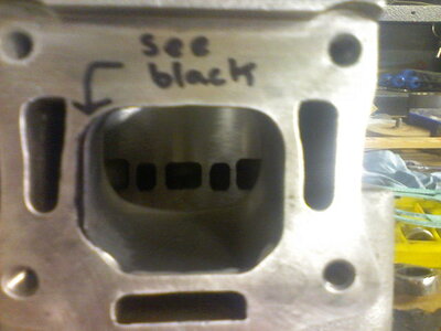

wsuwrhr aka Brian, can I steal this post a sec?
I have 1 of the very last cast Lamey cylinders that was bought from Lamey in Feb of this year. It is time for the annual re-build and I noticed the exhaust ports of the cylinders protrude into the manifold opening alot, but, only on the leading edges of the frt and rear cylinder. I took a couple of lame pics so u can see what I am talking about. WHats your thoughts/opinions? Is there enuf to make a performance issue? It does not appear to me that there is enuf metal to finish matching the ex ports from the cylinder to the manifold. It looks like on the frt cylinder that I would get into the frt cooling jacket real quick.
??? What u think?
Oh yeah, the black sharpie marks on the ex ports is the parts the hang into the openings of the manifold.

I see what you are saying, the bolt pattern seems to be right. What does the ex maifold look like, do the ports look to be in the right spot? Is is possible that the ex manifold can be shifted over?
One ex looks good, the other looks shifted. This is one of the reasons why I pushed so hard to get away from the cast cylinders.
Shoot me a call or let me know if the number in your sig is yours.
