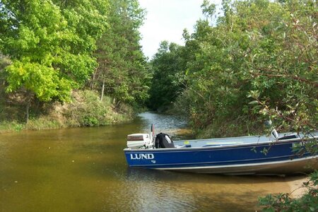

Up in Michigan I pretty much have a full setup...
standup, ski boat, fishin' boat........and a rowboat with a 9.9 on itlol..
I spent the first 33 years accumulating, now I have no place to store all this crap :bad3:
Im bringin' the blue lund back with me for some river fishin'.....
the Nacra's dont belong to me but I have full access.....those things scare the HELL out of me...they are 25-30 knot boats on moderately windy days.....
