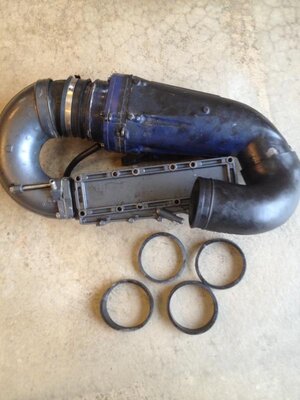

Im squeezing a 1200 triple into my 2002 SJ. I started this build about 4 weeks ago and have been updating build on pwctoday. My build goal is to have a OEM looking SJ when Im finished. Im going to post all the pictures up to this point. And then start with a day by day progress report. Please feel free to chime in with any ideas. Ive had many changes thru active mock up. Basically its a freelance learning experience. Ive relocated all structural mounts 3 inches forward with Gflex epoxy. Installed a 115 mm mid shaft. Retained stock battery, tank, and water box. Modified bed plates. 1/2 inch cooling. FX140 exhaust hose turning exhaust towards OEM water box. Using a combination of 2.5 inch aluminum tubing and OEM exhaust hoses to connect system. Motor is basically stock with 150 psi, riva cdi, air filters and taper bored carbs.
I like how you figured out how to use the OEM fuel tank. That is one of the sticking points of the 1100 superjets. Was the shorter midshaft an oem part from another model, or did you modify the superjet midshaft? Will the superjet waterbox and exhaust outlet be too restrictive for the 1100?
I can't take credit for the forward mount with gflex epoxy. I copied that idea from another ski. That crap is strong. The mid shaft is OEM SJ that's cut back and rethreaded to 115mm by Robin Haas. The waterbox will remain OEM SJ. The exhaust needed to be moved slightly on the carb side because the throttle linkages were rubbing. Other guys have used the OEM system and had no problems with back pressure or tuning. I am using the GP 1200 chamber.
