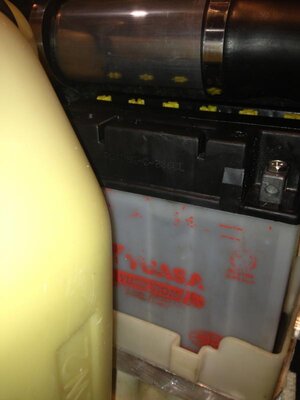

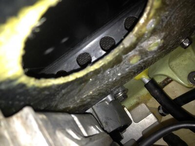

I removed the excess plastic from the bottom of the battery box and reinforced the sides with angle aluminum to create clearance for the OEM battery. Used button head allens to minimize height of fasteners. As you can see I now have room to fit a full size OEM battery. Might need that extra weight to balance out the exhaust.

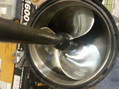

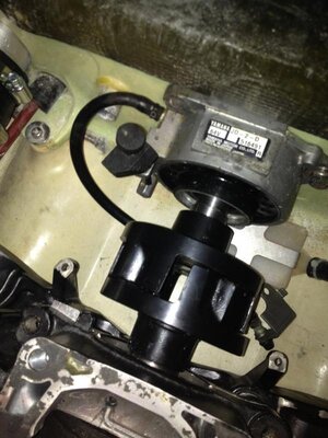

Mounted the mid shaft into housing and set back 20mm. Put a thin coating of regular silicone on the rear of the housing then fastened in place and added grease. Done.

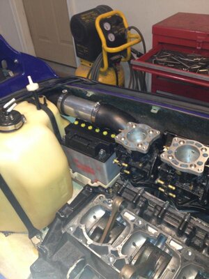

Need to order new crank, weisco piston kit, seals and gaskets. Need someone local to bore these cylinders.
Be sure to have the exhaust manifold torqued on when having someone bore the cylinders to eliminate distortion on the 1100 & 1200 engines and use the 1100 63M exhaust gasket because it has larger cooling passages.

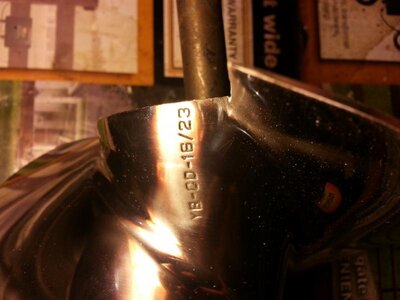

Back to my build after several months off. Winter sucks so I installed a shop heater and some tunes. Trial and error is all I have. I made a few changes and was lucky enough to get top secret advice from a member here. I will be using the stock pump with a Solas 16/23 -5mm hooked up to a jet dynamics top loader and oem ride plate.
Ohio
Matt - Thanks to Dave at Impros. He knows his pumps. Otherwise I would have went -3. A little extra is always nice.
That guy is great! Someone told me he keeps a book of riders weights and "hit" preferences and the props they ultimately choose to love.....I believe it because he has been spot on for me and many others around here over the years...
