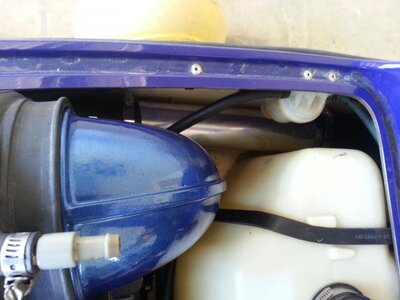

Completely rebuilt the carbs. Changed the N&S from 1.2 to 1.5. Returned jetting to factory specs. Installed new fuel lines. Drilled out the 3 carb restrictors and installed 1 in the return line. That will help balance the fuel pressure in all carbs. Installed a throttle bracket close to oem specs and straightened out the throttle cable for a straight pull. Works perfect.
A friend texted me pictures of his exhaust transition. I combined the two together and have a solution. I will install it during final assembly.
Added wire reinforcement to the hood cut out. Will drop resin and glass on it tomorrow. Added (4) 3/8 bypasses. 3 for the head. 1 for the pipe.
Modified the oem manifold. Reduced the width and created extra clearance for the exhaust transition. Lengthened the bolt threads then cut down to 4-3/8". Split cooling inputs x2.
