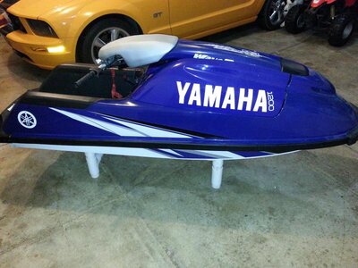

Tshank - unfortunately the only way to get the motor out is to break it way down. SJ 1200's are measure by the millimeter. No extra room. I think I can get it out, repair exhaust clamp and back together in 20 hours. Spent 6 months wrenching already. Looking forward to riding this ski.

Ive got the exhaust figured out I think, just have to get a custom water box and a through hull pipe under the tray. I am trying to keep the exhaust a 3" system all the way from the engine to the exhaust outlet on the hull.

Got out on the lake. Carbs need tuning. To much water in the exhaust system. Will install additional bypasses. No full brap laps yet. Will post numbers when tuned properly.
