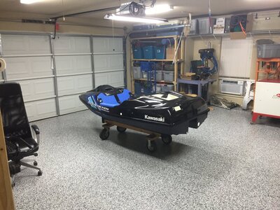

Turfing of the cockpit finally finished. Made the templates for the big pieces out of the stock pads and some poster board (thanks for the help, David - dude in the pic). The side panels templates were the worst, took multiple attempts with different materials to no avail. Finally got some I was happy with. Couldn't have done it without my wife's help. She doesn't realize how much help a third hand is. Pics below show the progress.

Been a long time since an update. Life has gotten in the way but I've been making slow progress here and there. Sand blasted and painted some parts, ordered and installed some bling. Also installed some new weather stripping for the seal that goes under the seat.
