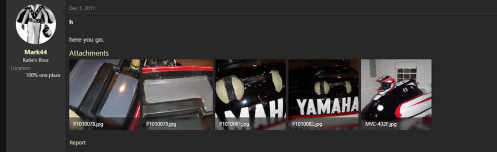

I would love to put hand holds on my hood. Seems that all the manufactured ones are not made anymore. I have searched and searched for diy ones or how to do it best and cannot find anything. Can i just cut holes in the hood where i think it would be best? Pretty curious on this.
You can make them yourself.Shoot me a pm and l’ll try and help you
I have been going through the thread that DylanS attached and the other threads attached to that one and like the way that Mark44 did his. Just making a fiberglass bucket out of a cup then sealing the hood liner again. Not sure if this is the best way but seems decent and not that hard. This will be the last thing i do though. I really need to get the other stuff done first.

On an old ski, I cut a triangle shape with rounded edges out of the hood. It was very comfortable to grab because I set it right where my hand would go and at the proper angle. I don't like the rounded holes as much. I used some cardboard to make a box and covered it in fiberglass for the backside, then glassed it to the inside of the hood. Worked great. Wish I had pictures.
Thank you for the info. I will play with some stuff out of cardboard and see what i like.
