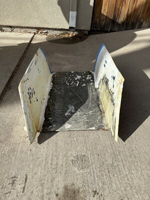

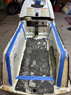

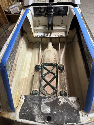

Well im gonna go for the cut tomorrow. Cutting on the front line of all the tape. Would anybody change anything?

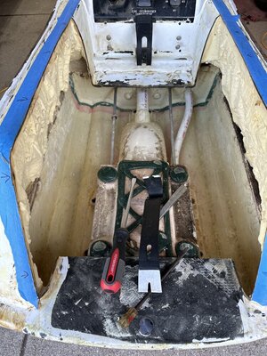

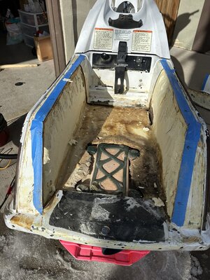

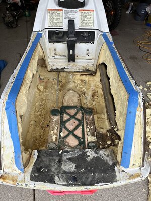

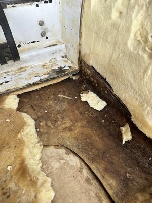

Thanks smoofers. I followed your cuts a bit. I am a little farther than the last pic shows. I took out the right side foam but still have the left to do. I did about 3 hours of foam removal today. My foam was soaked. All of it was wet besides the sides. I have about 1/4 inch of water in the bottom when the foam was removed.

Looking good!!!! You already defoamed!!!! That's a huge chunk of work already behind you!
Yeah I’m not quite there. I need to do the left side part. Prob 30 min left. How clean do ppl get these things. It’s hard to get every last bit of foam. I think just making sure I get it really clean around where I need to seal.

that's pretty much the ticket. You can't get every last little bit. Do the best you can and make sure the areas you're going to epoxy or seal to are clean and bare glass. Keep up the good work. Looking forward to seeing your progress.

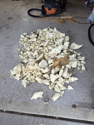

Got all the foam out. Pretty excited. I think it was about 4 hours work of work just for the defoam. I think the crow bar thing worked the best with a little bit of chisel and flat head work in the real right areas. I just need to use maybe some steel wool or sand paper to clean up around all the pipe mating areas so that I can caulk. Just bought a big tube of 5200.
Besides all the tubes , insert areas and exhaust what do ppl seal? Do you seal up all the bond line? Any areas around the pump?

The bond line definitely needs to be sealed.
