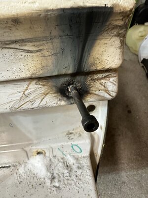

Pretty pumped. After over an hour I got the broken ride plate bolt out. First I tried for a while the way Erickson m&p way with vice grips and a nut but I could not get the weld to go down and melt into the bolt with my little 110 welder. I almost gave up but figured I would try to weld a bolt on. I got one on but it broke off. I ended up getting a second bolt on and I made sure to weld all around it. And I got it out. All the black stuff wiped off. It burnt a tad of the fiberglass around the hole but not bad. I also got the pump shoe out. So I’m ready to clean that up and get the new one back in.

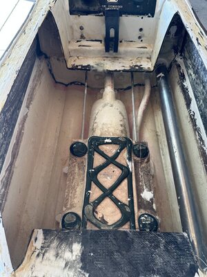

Got the pump shoe in. Went in pretty easy. It’s the pro watercraft one.
One question I used their recommended silicone for the pump shoe which is IS800 series adhesive. I have a bunch left and it’s already opened. Can I used it for sealing up the inside of the tray? Or should I used the recommended 5200 for that. I have the 5200 tube already but keeping it unopened would be nice.
Edit: another question do I need to replace this pump seal? It has a smushed down part to it. Does not seem fully dry rotted tho. Pic below.

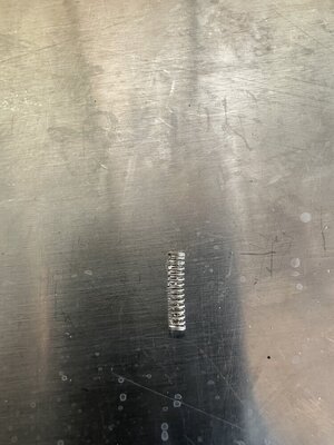

Spring pic is below. With a pic of all the springs from mikuni. I’m thinking mine looks like the one on the left which is 115g. Mine measures .564 in length.
When I was riding it before it seemed to load up on first start up in the water from the beach. As soon as you hit it it would clear out in a couple seconds and then run well from what I think. Prob not perfect.
The carb was a bit dirty looking and needs rebuilt so not fully sure if the bog was that or jetting. Does the jetting seem close? Should I drop anything leaner? I was told this was sea level b pipe jetting for the motor that is in it. I have the dry pipe so I would guess it’s close.

Measure the pop-off pressure, then look-up your Spring in the Mikuni Chart along the 1.5 Needle Valve Size row.
You need to do the Pop-off tests anyway to check for leaks and to know what it is.
Stock OEM Jets are #70 and #135 for Sea Level.
Factory Pipe Type 4 Dry Pipe Jets are #75 and #140 with Stock OEM N&S for Sea Level.
The High Elevation reduction in Oygen, which leads to a Rich Condition with Sea Level settings, can be accounted for by turning in the Carb Adjustment Screws as needed.
Use a Tachometer for Tuning.
The Pop-Off might need to be slightly lower than spec'd for Sea Level, since the higher altitude atmospherice pressure is slighlty lower than at Sea Level, thus the Needle Valve opening a little later for the Spring being slighlty too "strong" to be overcome by the Atmospheirc pressure.
Because the Needle Valve Spring is opposed by the Regulator Diaphragm and the Regulator Diaphragm is "pushed" by Atmospheric Pressure.
Short story, adjust Low Speed Screws until a crisp snappy response is obtained fron Idle to WOT when kneeling on the Tray at Idle. I call it the "Whiplash Test." ;)
If it hesitates or even dies, the Low Speed is Lean, so OPEN the Low Speed Screws. If it gurgles, loads up or responds "dirty", then it's Rich so turn the Low Speeds IN. Make the adjustments 1/8 of a Turn at a time.
Make sure you're synhcronizing or turning them IN or OUT the same in both Carbs. Too easy to forget or get distracted when turning Screws. Many People will turn one Carb one way and go the other way on the other Carb by mistake. Happens more often than you would think.
Pre-set the Carb Screws on the Bench so you start from known Turn Settings.
The more Advanced Tuners will adjust each Carb individually by treating each Cylinder as an independent Engine. But that's another Story.
Make sure the Throttle Butterflys are synchronized after you install them. Adjust until the Butterflyes are dead even. Eyeball is good; ************ Gap Gauge even better.
Odd how the Word F-E-E-L-E-R is not allowed...

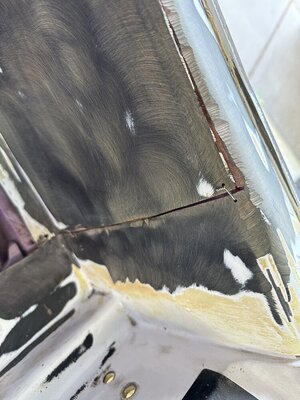

Well I got it all zipped up with safety wire. Then I got one layer of glass on it. Probably do just the 1 layer and then cut out for the foot holds and glass it all back. Then probably 3-4 layers total.

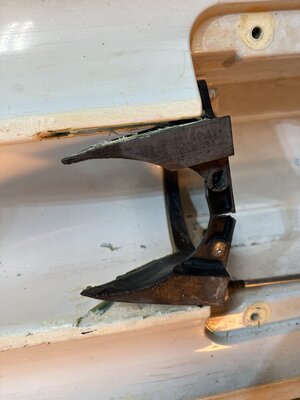

I have both side footholds fitted. Just need to get them epoxied and riveted in place. Mine fit like crap. They are cheap ones that are prob homemade. I will prob have to trim and stuff on them a tad.

You've come this far. Don't be afraid to trim the holds to make them fit properly. You'll be much happier in the long run if you take the time to do it right. Keep up the good work man.
I will trim them some. Bit confused on how to trim them to make them fit well. I think trim the top flange down in all areas. The main issue with these is they dont sit quite flat so i will need some help from screws to get them to flex down a tad.
