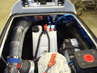

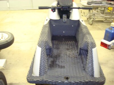

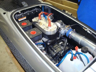

just weighed in my s/j 66e with out the tank, manifold, and batt and got 285 lbs. when all said and done it should be around 310 lbs. thats with reinforced hull, foot holds, waterdawg hood kit, and a umi hand pole with all the goodies. the tray was defoamed and refoamed also so you know there is no wet foam.:bow28:
here is pics of mine
and just so everyone knows ! it totally rips!

nice work, gas valves are on my list. did you get them through riva? what head is that and whats your comp @ if you dont mind me asking?
gas valves i bought used over on greenhulk
riva non gird head pro series 33cc domes
havent checked the comp #s
kart tank from comet cart sales 2.3 gal
