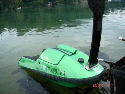

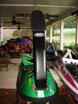

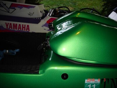

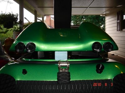

Some pics of the pole and my air holes.l used #80 pvc 3/4 I/D threaded and barbed connectors.l bought some caps to screw on,but before installing l cut the end of the cap off,rounded them off and then put Frogzkins screens in them to keep the water out.Go ahead and someone tell me they look redneck! lf l chromed them,they would be!! How about some stacks on there going straight up.lol
I think they look good. not as redneck as you made them sound. I may have to do the same thing. Is the pvc barbed on the inside or something pretty much just like a large pvc water fitting that you would normally use for your water lines?
