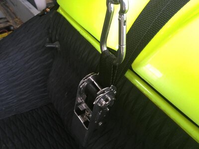

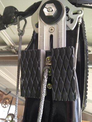

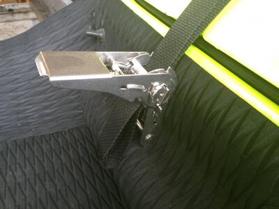

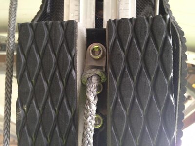

Got a question for you freaks.Where do you attach the end of the limiting rope on the pole? There is no provision for it

What pole? On the carbon pole that Tem built for me, I drilled a hole near the steering stop, into the bottom of the pole. I fed the limiting rope through it and tied a knot. Burned the knot a little to make sure it doesn't come undone.
Here's a couple pics for a limit strap mounting option. Pics are in no particular order again ha!
