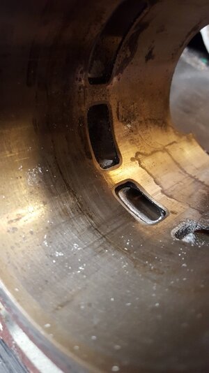

And then, shoutout to @yamanube for his porting templates! If you're interested, go here. I'm not going to bother explaining the process too much, since that's been covered before on this forum (also, there's a good thread on porting here). I kept it simple, just did the cylinders. Decided to stay away from the case for the time being.
Of course, my Craftsman rotary tool quit on me halfway through the port job... Thankfully, a good cleaning brought her back to life.
Here's the end result for the exhaust port. Took much longer than I expected.

Thanks Jason! I did touch the leading edge of the boost port as well, just didn't snap a pic. Yours looks better than mine I think, maybe I should have gave it a little more love. But ya, I've been jumping back and forth between projects trying to get everything ready, so things have been pretty crazy around here. I'm definitely feeling the pressure (baby is due in about a month).
