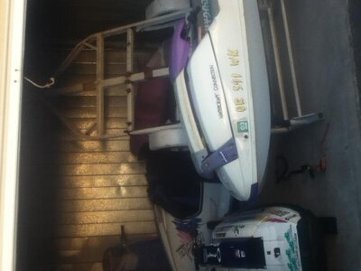

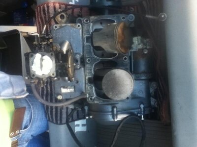

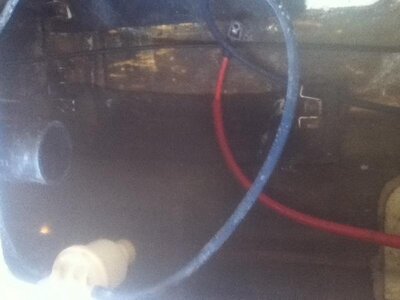

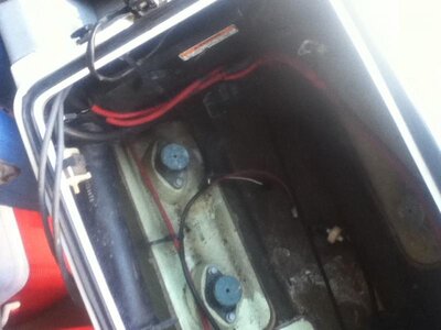

I pulled the engine, water box and gas tank, the 3 screws with the massive Phillips head that mount the ebox to the tray are gnarly, and they will not budge. I will have to take it to get the flywheel and stator pulled by my friend at his shop. Then ill split the cases and pull the crank. The stand my uncle gave me is a perfect shop stand haha.

get an impact driver for the phillips screws holding the ebox in before they strip! Autozone rents a puller that works perfectly for pulling the flywheel if you want to do it yourself...
I like to work untill I get stuck in something than have someone with experience who's willing to help step in and tech me how it's done. Thanks for the edvice, didn't think of impact driver I tried a bit on a huge ratched and it wouldn't budge. Going to be getting the engine parts and then will have my friend guide me through re install. My first order of business will be letting Jason work some magic on the hull. I'm ready for any amount of sanding I have to do in order for Jason to make my hull like new again haha I want this thing solid because I intend to put some dough in this and progress my skill onto barrel rolls and such haha. I need to seperate the engine from this thing, so either ebox comes off or I pull the stator and flywheel to get to it them apart. I can't wait till after Christmas when I can save up to get these parts!

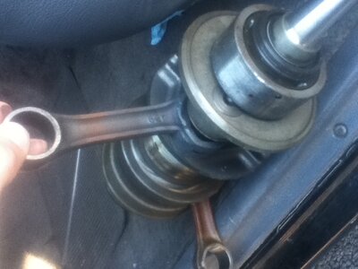

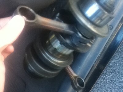

So with the help of J the bad crank is out ready to replace. He's filling in the small nicks underneath and then the 61x/61x from my superjet will go into the fx for me to ride.
The 61x from the fx1 is torn all the way down for the new crank and I got hooked up with a 760 cylinder and .5 over pistons, ill be able to get it bored and honed .5 over and eventually rock the 760 in the fx. I'm so stoked to get to ride this bad boy.
