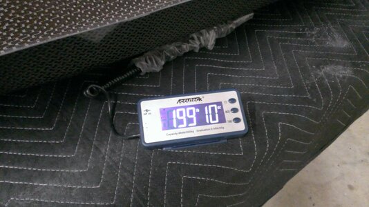

Well I won't drag this on any longer and start firing some pics and weights out. Also I did verify that my scale is accurate, by referencing it to 2 other calibrated scales.
