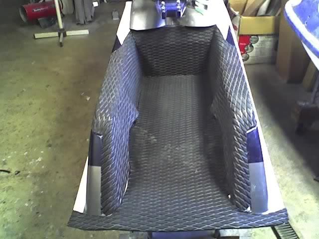

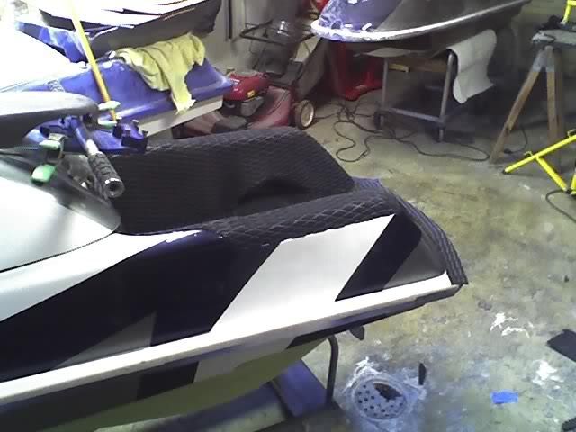

got tray turfed today.just gotta do the rails.it turned out nice i did the back corners with out cutting them

you gonna turf those rails bill?

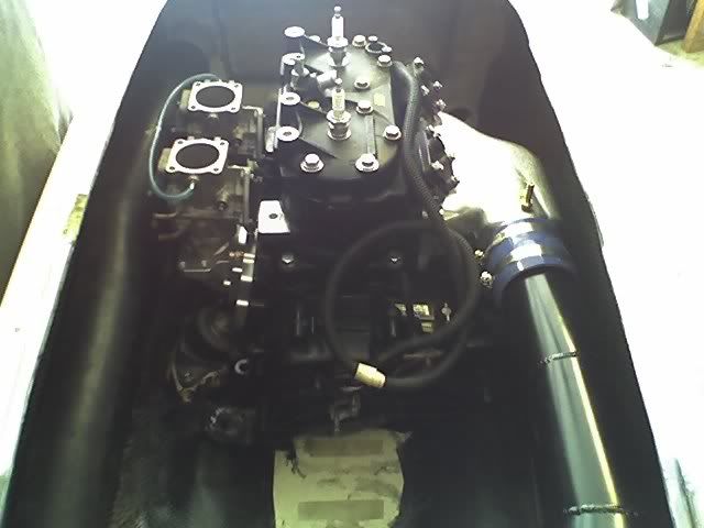

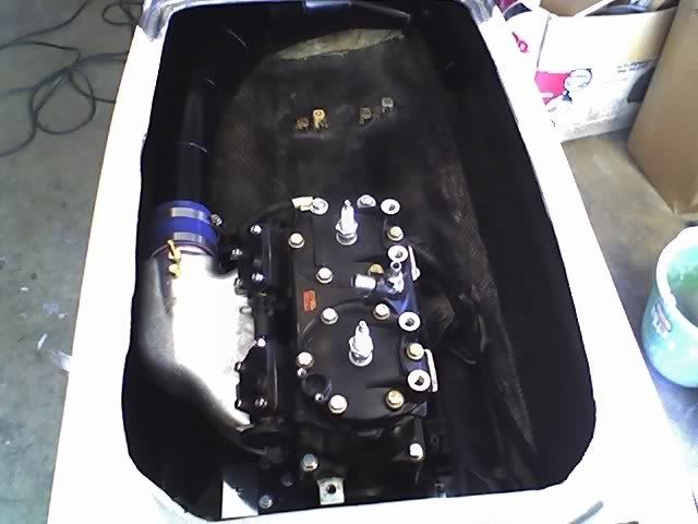

chris and i fought all day and got the motor in and shimmed ect.I called jeff and he said hes gonna send out the mounting plate i need for the lord mounts in the front on monday.I had glassed in 2 plates to mount the battery in front of the motor but the 66e is a little longer so i couldnt use them and i didnt want them in their so i had to grind them out that and i will glass a peice of carbon back over that area.
This wk get the pole and bracket on and all the cables ran.
bore cyls and send out to get plated
get pump in
then just gotta glass the handhold cups in the hood and its ready for the water

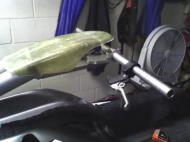

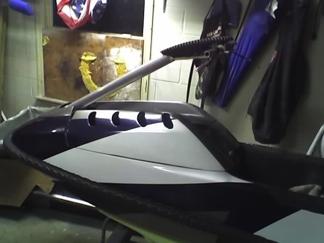

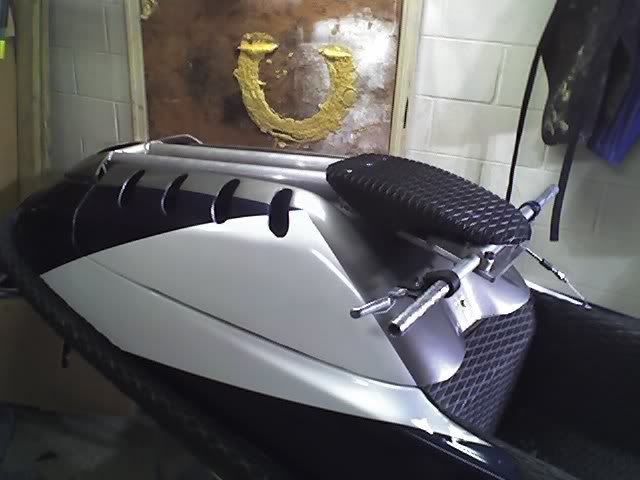

I got the turn plate made and the bars cut and everything fitted to the pole.also finished the pole and ran all the cables to make shure that everything woul work out and i couldnt be happier with it.
The rails are turfed and Chris laid up a nose peice for me so i could keep rolling and get the turf done thanks chris.
I also made up the pole bracket out of 6061.everything is mounted its not on for good gonna go back and do some more to the turn plate and i need to decide if i want to paint the pole or let it the alumnium color.
