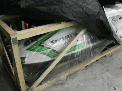

my bud has a brand new X-2 in the crate $12,500
