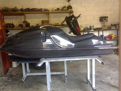

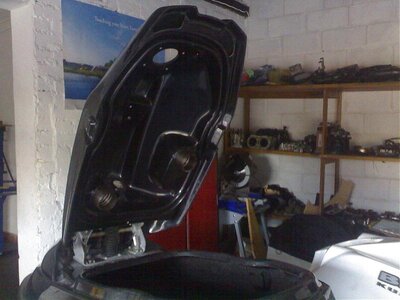

Pump in - did a 10mm set-back on the whole unit
Modified R&D scoop-grate on
The carbon rideplate has been D-cut
The rear lip of the hull had to be cut for trim-system(+- 30degrees trim)
Hood is on
Steering is next

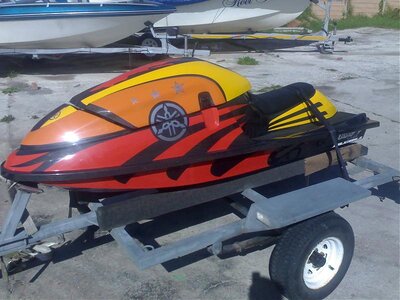

Rotation that is freaking sweet! So how hard is it going to be to get the Yami engines to mount up in the X2 hull? If a 1100 Kawie engine wasn't so heavy, I would suggest one of those based on that old pic of an X2 with one floating around. Then I got an 1100 ZXi with a blown engine and realized it was way too heavy!
PM me your contact for Jet Wave. I tried emailing them for some parts at the begining of summer and got nothing back. I will definetly want some goodies this winter!!

The mounts are easy as the hull has aluminuim pads running the length where engine mounts need to go, just mark, drill and tap.
The driveshaft will have to be shortened though

Ski full of dust
Nozzle to be powdercoated

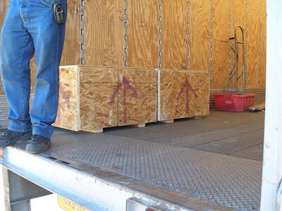

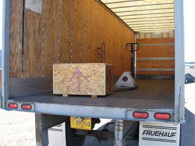

They are COMING!!!!
I wonder what is in the crates!!!:hail::hail::hail: How about 2.4 litres of muscle. I can't wait to see the new X-2's with these motors. :fest30: Let me know when you get them.

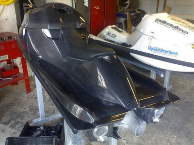

UPS now says will have motors 7 Sept at latest.
Some BNG for the ski:Banane36:
