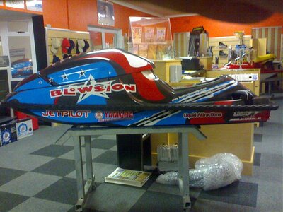

Glassed-in exhaust mount with some 400g cf
Fitted tank.
Put some 'BLING in the tail'.

Sorry, they won't roar but will actually be fairly quiet, I am building waterboxes for them that have 3 stages to kill off the noise as a lot of displays will be on man-made lakes inside of entertainment complexes.

Forgot to mention that on my partners X-2 there are carbon tubbies. Going to compare the handling before I decide if I am putting some on mine.

CF tubbies made and fitted by local boat manufacturer.
Checked the porting with TSR Software, power peak at 4500rpm, looking at changing porting a bit
Finished the cutting of waterbox, still needs to be welded. It is very effective for reducing noise with low backpressure, built it with 3 different diffusing/resonant chambers, weighs 4,2lbs.:bow28:
