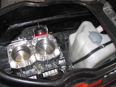

Had to do some mods to bedplate but now can use stock mounting holes in hull. Exhaust fits quite easy, slight remould on tank needed.

Sorted the mount for exhaust today, stainleess steel bracket tacked in position with quickset epoxy. A friend just dropped off some carbon pieces, will glass-in mount tomorrow.
