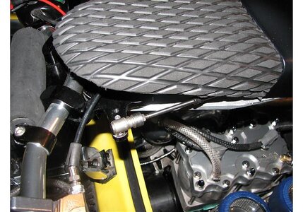

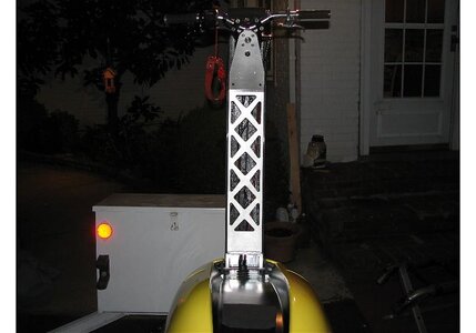

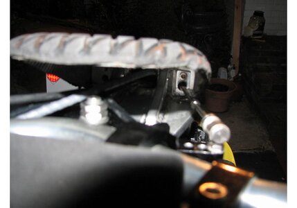

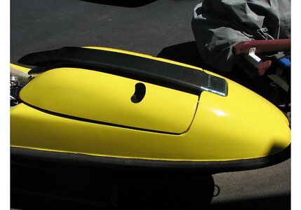

Did some test riding with the new WDK pole and I must say that it is impressive. Feels very light and very sterdy. The construction is spot on with the X-jet billit bracket and the system as a whole is machined to some impressive tolerences. This is evident when installing the streeing cable. It is kind of a bear to get into place but that is b/c the hole it slides through is just big enough for the cable. Once that is buttoned up the cable is securly in place and has better geometry to the to the turn plate.
My only criticism with the pole thus far is the handlepole pad needs a support bracket if doing hood tricks, but that is a easy fix and it would be benificial if the carbon skin was bolted onto the frame of the pole. That way it can be removed easily. It is bonded to the frame as of now.............no big deal but if there ever were a problem with the skin it would allow for easy replacement.
Cable routing through the pole is a breeze. Add a few zip ties to bunch the cables together and it will look great. This whole set up is so tight and sterdy that the only play I get anywhere is out of the turnplate assembly and bars. :brap:
Hope to report back more performance info as I ride more.........I had some drive train vibration and need to get that squared away before I do anything else.
Pole pad is turfed w/ 8mm padding and diamond turf

Looks sweet..but I think you need straight bars...those stick out too far past the pole pad.
may want to run a screw in the nose piese on the front. boss bailey was showing me his seperated wdk hood liner the he did a barrol roll and his nose piece popped off . the little metal bracket on his nose piece in the front didnt hold it on after 3/4 roll attemp off a cruiser wake.
SuperJETT
none
This is the X-Jet, the entire front is solid, no nosepiece to worry about coming off.
i do belive that there isnt a nose piece.its all solid and part of the hull
you are referring the the XJet, he is talking about the SJ Hood that WDK sells.
It comes with a regular lowered nose piece.
