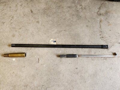

Out of necessity I made the "Jet Ski RamRod" or "Hooker Hooker".
Sucking up stuff during spring run off (snow melt and rain causing all the debris to wash off the mountains and end up in the rivers/lakes) can really leave you near or actually dead in the water. With the flows getting very high in the river this time of year - losing propulsion or most of it can put you in a losing battle with the river!
The design is basically a compact hook to pull poop out of the pump and then a blunt end on the other side to push poop through the pump. It sits in the hull on the left side and is held captive until you push the quick disconnect and separate it.
I through some rubber hose to hold the hook end and gorilla tape on the blunt end so it didn't rattle around like crazy. Seemed to work!
It got enough use that I felt really good that I made it during this weekend trip! Probably had to whip it out about 10 times total. We covered 100+ miles on the river tho so we put ourselves at it's mercy haha!
That is pretty cool
